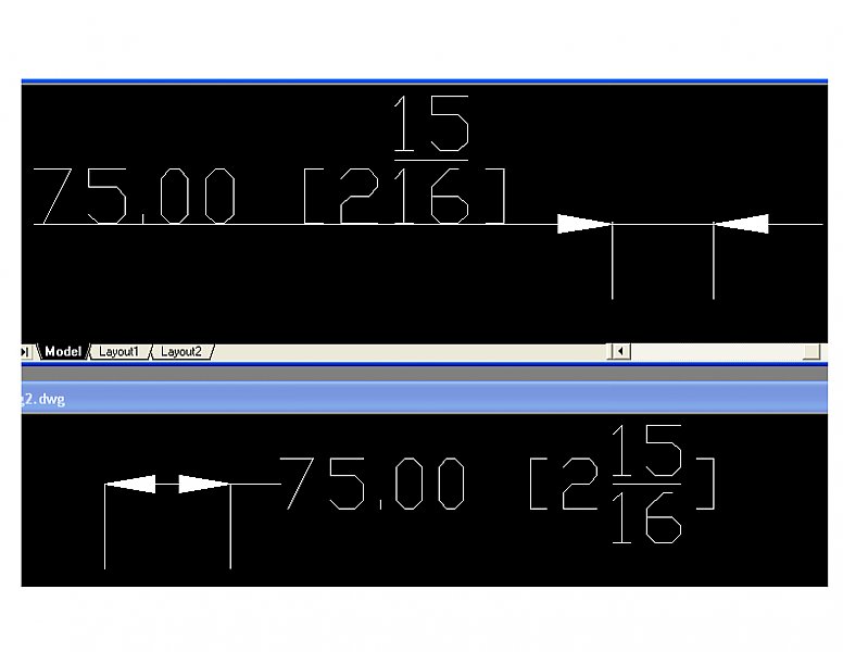

Look at the position of the number '2' on the fraction. When I start a new drawing, the default looks like the upper image. I want to make it look like the one below. How do I do it? Thanks!
When in the Modify Dimension Style dialogue box, navigate to the Alternate Units tab. Once there, set Unit format to Fractional Stacked, and then set Precision to anything other than 0.
You might also want to consider reducing the fraction height scale to something less than 1. I opt for .75 as I think it looks better.
