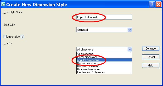

Have you tried making a 'Child"' dimension style for angular dimensions?
A much better solution - I'm showing my inexperience as a CAD user... :oops:

I agree the most logical way would be to create a 'Child' dimension style and specify it for the use of angular dimensions. However, in the Modify Dimension Style window for this child dimension, the Linear Dimensions section of the Primary Units tab is grayed out and therefore the suffix (in my case 'mm') can not be deleted! This results in angular dimensions such as 60mm which doesn't make sense.
There are only 2 ways I know how to solve this:
1) When creating the 'Parent' dimension style, don't specify 'Use for all dimensions' but only for linear dimensions. (This still bugs me though because the suffix option was in the 'Linear Dimension' section and therefore should not be applied to any other type of dimension in the first place.) Then create another dimension style for angular dimensions.
2) If you only use angular dimensions rarely, like me, fix each individually by a) double-clicking on the angular dimension for its Properties and change the dimension suffix (in the Primary Units section) or
b) Select all the angular dimensions and click Override or type DIMOVERRIDE, then type DIMPOST, then type . and press enter.
