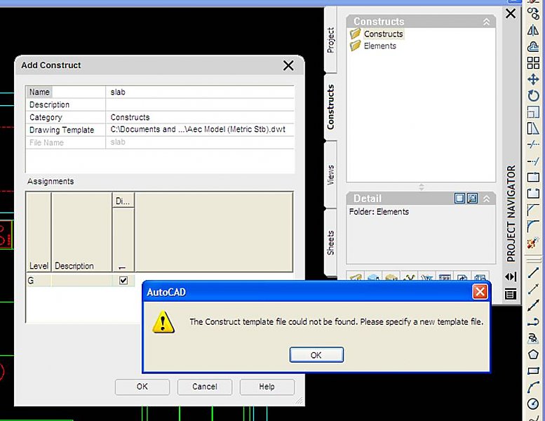

I am trying to do such a simple thing as creating a new construct in my drawing. But when I am ready to press ok, this message turns up: " The construct template file could not be found. Please specify a new template file."

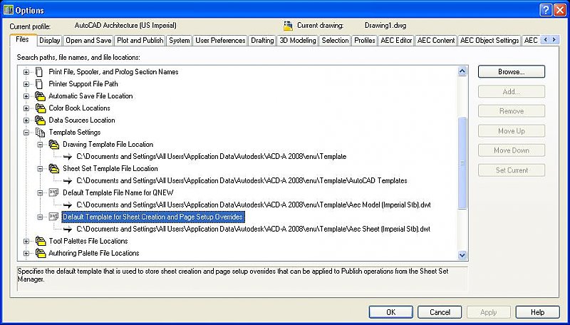

Get of a screen print using Ctrl + Alt + Prt Scr (like the one I have posted). And let me see your settings.
Settings can be found here:
Format > Options > Files

Open DWG file. Then right click on constructs-> new-> construct.
Naming it, checking the floor level -> ok.
Then the message occurs, looking like this:
Follow the support path (as seen below). See if you find the template.

I have now followed the path, and I probably had moved it at some point, even though I cant remember it. anyway, it is in its right place now, and it is STILL not working! Going nuts here!:?:wink:
