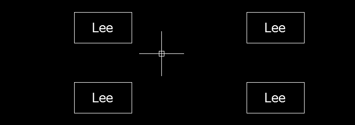

Lee Mac Posted August 13, 2009 Posted August 13, 2009 Fields are good, but you must use an MtextAttribute - I have a LISP that will update all similarly tagged attributes with the correct field: Quote
alanjt Posted August 13, 2009 Posted August 13, 2009 Fields are good, but you must use an MtextAttribute - I have a LISP that will update all similarly tagged attributes with the correct field: [ATTACH]13732[/ATTACH] what else would you use? fields work in mtext, dtext, attdef. Quote
dbroada Posted August 13, 2009 Posted August 13, 2009 Fields are good, but you must use an MtextAttribute Lee, I'm confused. I used a normal AttDef which worked. Is this an MtextAttribute? Quote
Lee Mac Posted August 13, 2009 Posted August 13, 2009 what else would you use? fields work in mtext, dtext, attdef. Lee, I'm confused. I used a normal AttDef which worked. Is this an MtextAttribute? Yeah, sorry, not sure what planet I was on when I wrote that Quote
