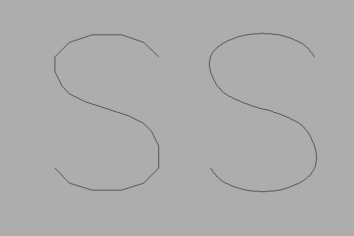

RomanS font is a series of straight lines as drawn.
But if you explode it, and then curve fit the resultant polyline, you get a smoother font than the original.

Join the curved sections only of the character into a ployline and curve fit. Leave the straight sections alone.

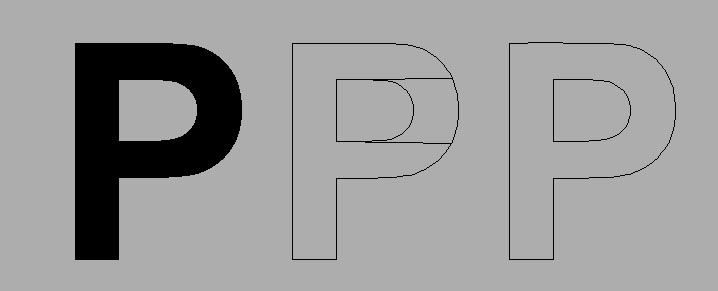

Surely E & A don't have many curved sections. It may be quite fiddley to create perfection, but if you want it, you have to spend time.
Here is a picture of a P character in Arial Bold, then when text exploded, and the third is of curved parts joined as a polyline and curve fitted.
