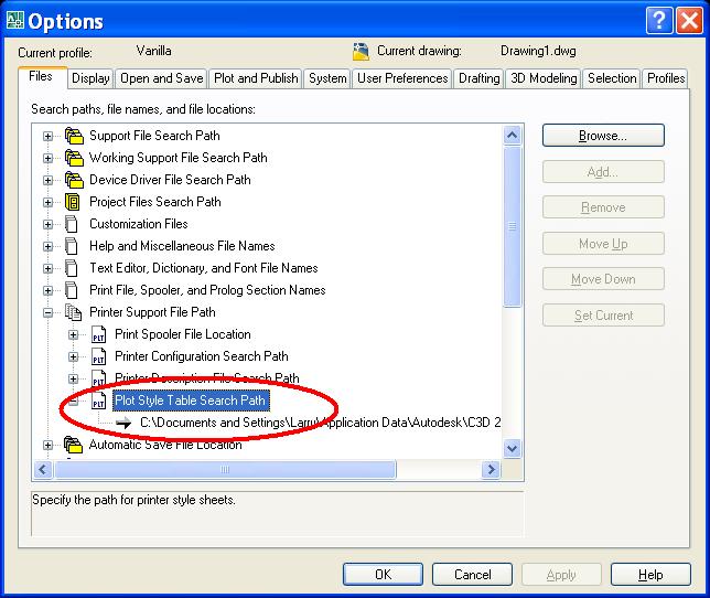

Be sure your .ctb files are located in the folder designated in Options > Files
