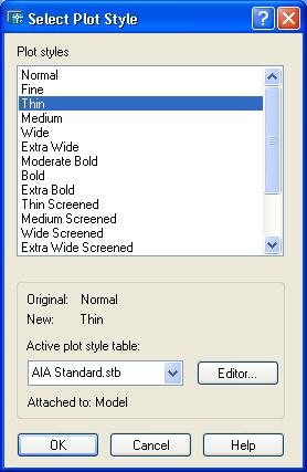

Hello, I have down loaded the cutepdf writer.
It is easy & appears to be accurate.
I need to print architectual drawings in black & white.
I have made the setting change from color to black & white.
But I find that many of the colors do not print.
Is there some way to rectify this problem without having to change the colors in my autocad drawing?
You are using AutoCAD 2004, correct?
Set all your layers to plot as thin. Full saturation with newer versions.
Cutepdf has a dialogue box for setting colours to line thickness, similar to an autocad .ctb, I havnt got it on this laptop but from memory its in the properties through the Start Menu > Printers.
(Could be wrong it might be in the options when you plot to printer cutepdf; but Im sure you will find it now you know its there).
