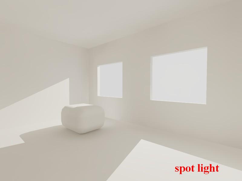

ok, here some render test...
same 3d scene
same render settings.
but one is sun & sky illimination
and the other spot light (used to simulate sun)
what are your judgement?
sun? or spot light?
I think the Sun & Sky is giving a more realistic look. The spotlight is giving a more even light though.

Spotlight will slightly deter the shadows from their right direction, sort of producing light at a radial direction, hence the shadows will be cast in an unnatural direction (as seen in the first render), unless you place it very distant from the model.

I cant remember, the file was deleted a long time ago, but from the top of my head the intinsity of the spot light shouldn't be lower than 30-40, and spot light is more time consuming than the sun, and the sun can give more natural shadows than the spot light, but its your call.. its up to you sun or spot light. and feel free to ask.:D

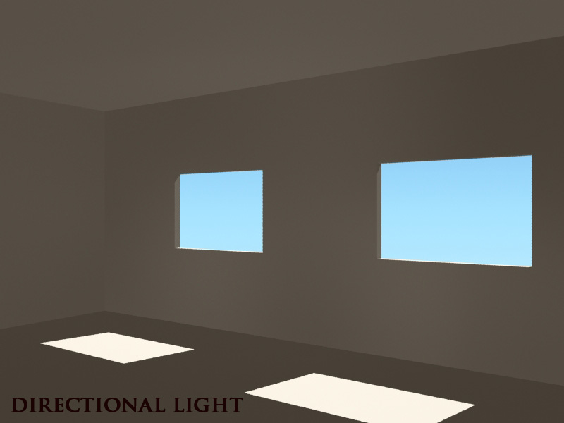

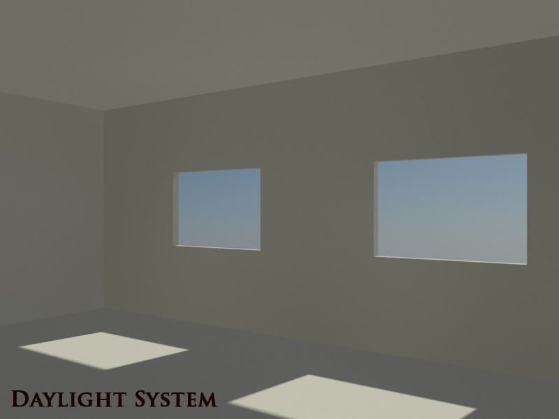

Hmmmm, I'm not sure why your lighting is so blown out in the spotlight render? Something is definitely wrong there. And your Sun & Sky render is blotchy. I think you need more photons.
Below are two quick renders I just did in Studio Max. One using a Directional light with FG & GI enabled, (Never use a spotlight as your main light source/sunlight), and one using a Daylight System, (Similar to Autocad's "Sun & Sky").
As you can see, they look almost identical except for two things.
1. The Daylight System render took 1:25 to finish, but the Directional Light render took only 0:59 to finish.
2. The Daylight System render looks very grey and washed out, but the Directional Light render looks much more lively and vibrant.
I never use the Daylight System because everything is too automatic and I feel like I don't really have much control over the final rendered image. This was just a quick test, but with a good lighting set up and some tweaking of the settings, you can produce renders that look better than the Daylight System/Sun & Sky.
