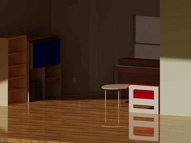

I am trying to render this living room and I need help on adding light.

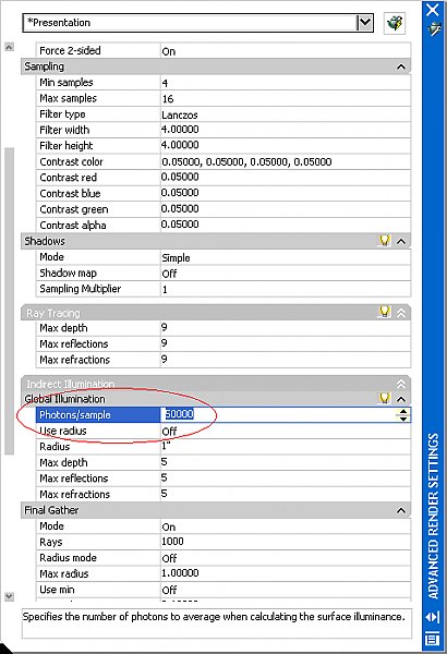

I first added lights but that didn't do anything. I tried different types of lights as well. I adjusted the Photons and it still came out dark. I rotated the house to allow the sunlight to come in, but all that did was light up the floor. Any advice? See the attached images.
Thanks in advance!
change the intensity of your sun a bit in the sun palette. and the time of day to be a bit earlier, this should bring the sun down more to the horizon and allow the light to come in more.
Just use a light and turn the shadows off to light up the room. Adjust the Attenuation as well. Also, don't worry about "sun" lighting for rooms. :)
I currently have 2 lights placed in the room but I can't get them to turn on... Any advice?

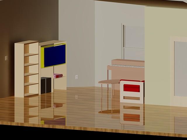

I was able to get this to work!! :D Here is the final result!
ugh, quit with the orthographic views. Always render perspective if you can, looks more realistic. :)
But the render did come out very nice indeed. Good job. Keep up the good work. :thumbsup:
How would I render in perspective?
The easy (and considered lazy) way is just to type PERSPECTIVE at the command line and set it to 1. Get the view you want, and render the scene. Best practice is to have a Camera view set. :)
