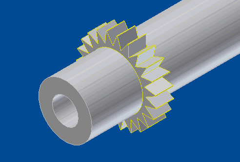

I am trying to ultimately create a driven constraint to rotate a wheel about a center pin. I have a tutorial for creating an angle constraint between 2 opposing faces of a hinge, but I can't figure out how to set up for a wheel and pin. This has got to be pretty basic for all you Inventor gurus...help Please!
If your trying to create a rotational relationship, you have to constrain the axis of the pin and the wheel.
KC
The pin and the wheel are constrained with an Insert Constraint. I was able to solve my problem by selecting the XZ plane for the pin and the YZ plane for the wheel. I came to conclude that the angle constraint needs to reference 2 flat surfaces; both sharing an XY or Z plane. Since all flat surfaces of my 2 objects are normal to the rotational plane, I could not select any surface of my objects as a reference. Thanks for the reply though.

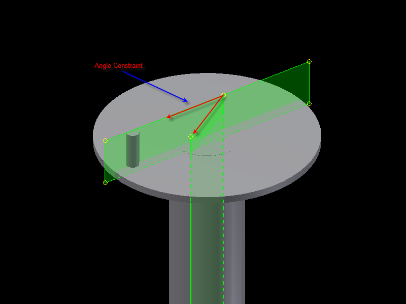

is there a tutorial for the rotate constraint ....
i am trying to get a top plate to turn on a pole..lol

A rotational constraint really wont do you any good unless their are two rotating parts. Try an angular constraint between the XY planes of each part. Then drive it.
