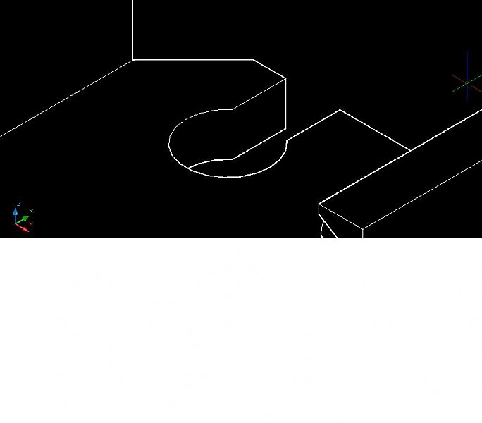

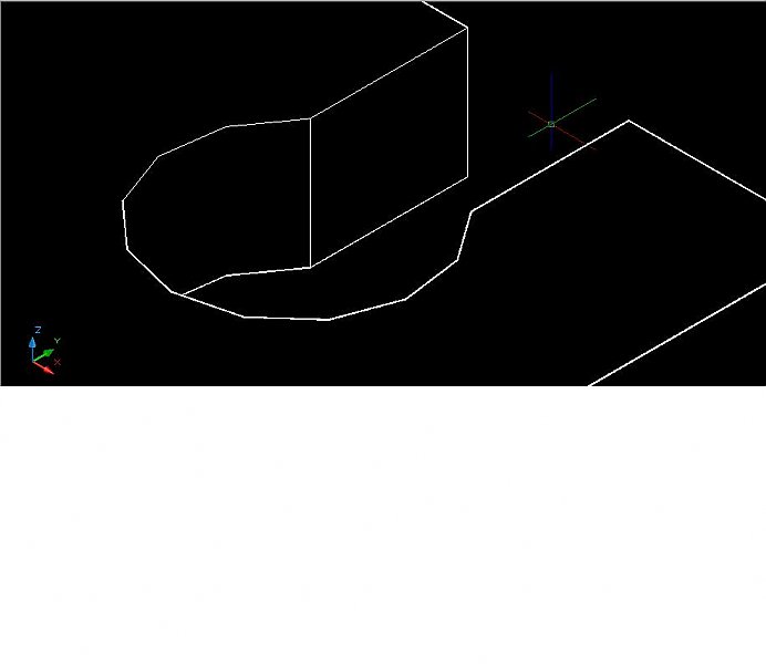

I Don't Know If This Is Just My Graphics Card Or Settings Need To Be Adjusted But If Someone Can Help Me Out Would Appreciate It. In My Drawings When I Zoom In Sometimes I Can Regen And It Cleans Up The Edges But Most Of The Time It Doesn't. I Do Draw Small Things So Could It Be In Units Or Somewhere Else?
hi, try typing it VIEWRES, and change it to 20000 that might help
i tried did not help.....any other suggestions?
Type 3DCONFIG, go to Manual Tune, and uncheck Dynamic Tessellation. This helps smooth things out after setting FACETRES and VIEWRES.
Thank You That Helped Looks Much Better Now Will I Have To Do That Each Time I Draw Or Is It Set?
Nope, it will be set from here on out. Be advised that this greatly reduces performance when dealing with large 3D files as it smooths out ALL rounded 3D edges. If you start seeing a hit in performance, turn this feature back on. :)
Oh Ok Will Keep In Mind, And Thank You Again
