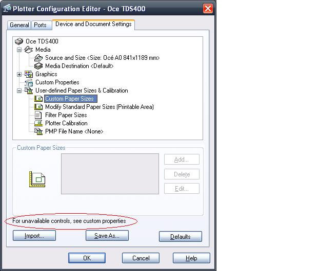

dixie_boysles Posted August 18, 2009 Posted August 18, 2009 im new to the forum, i use autocad everyday at my workplace. currently we are on 2000 and 2002 (we have another program called Diecad which is a german program that uses AutoCad program code and integrates its own code to add on to AutoCad's capabilities; it is specifically for granite fabrication [i work at a granite quarry]). my problem is: sometimes i need to be able to print full size layouts (1:1) of the drawing im working on. Well it doesnt always fit on the preset lengs of paper such and an a sheet of b sheet etc... In autoCad, you can set "Custom Paper Sizes". Well i have XP on my computer and for some reason i CANT set custom paper sizes!!! the boxes i need to do so are grayed out...like this The wierd thing is that another draftsman had windows 2000 when i started here and he had the option of setting custom paper sizes. now he has XP and cant.....! any ideas guys? this would be a BIG help if someone knew what to do. Quote

chelsea1307 Posted August 18, 2009 Posted August 18, 2009 "For unavaliable controls see custom properties" I have you checked that. Mine's greyed out too but through there i can add custom sizes to plotters that accept it. Quote
rkent Posted August 18, 2009 Posted August 18, 2009 Simply pick Custom Properties, it is two above the Custom Paper Sizes, then Custom Properties button, then probably an Advanced tab, finally paper size, for PDFs anyway. For other plotters once you pick Custom Properties, custom properties button, the paper size tab will be shown. Quote
