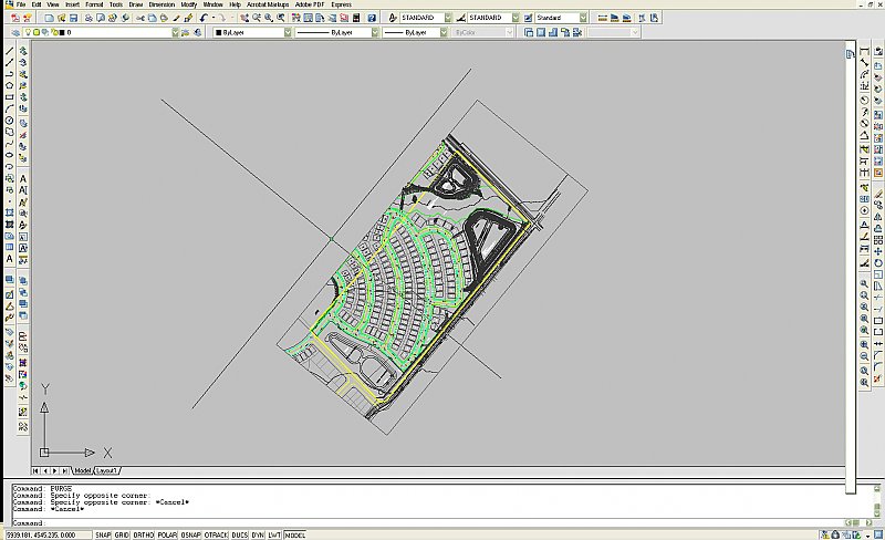

So I have a drawing that I have received from an civil engineer.... this drawing is oriented to the World UCS (surveying purposes I presume).
As you can see (image attached), my ucs icon is aligned in the default location, the drawing is oriented as such, do you notice my cross hairs? They are aligned with the drawing not my ucs icon. My ucs is at their default settings...
Anyone else run into this problem? is there a fix? I've tried aligning the ucs to the way I want it but it doesn't seem to work.
Can you change the angle of the crosshairs with the SNAPANG command?
type: ucs
or, as remark said, check your SNAPANG an set it back to 0.
Many thanks ReMark! - That's what did it!
