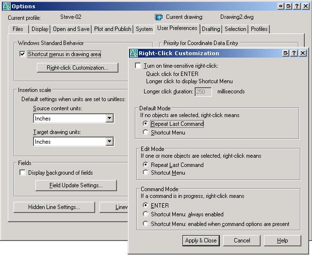

StevJ Posted August 19, 2009 Posted August 19, 2009 Right-click is already being used by Autocad for other things. This pic from Autocad 2006: Steve Quote
