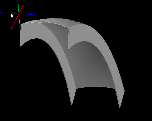

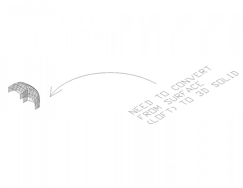

Fire Alarm Posted August 20, 2009 Posted August 20, 2009 Is there another way to convert a surface to a solid other than the CONVTOSOLID command. I tried using it and it did not work. I cannot upload the drawing file because it is too big, but I did attach an image of what I need to convert. I will email to anyone who might have an idea, on how to get around this problem. Thanks for all the help. Quote
ReMark Posted August 20, 2009 Posted August 20, 2009 Maybe the Face-to-Solid lisp referenced here will do it although I'm not sure why the convtosolid command wouldn't. Link: http://discussion.autodesk.com/forums/thread.jspa?messageID=5305011 Quote
Fire Alarm Posted August 20, 2009 Author Posted August 20, 2009 I will the lisp a try and hopefully it works. If you want I can email the file to you. Maybe there is something that I'm missing. Quote
ReMark Posted August 20, 2009 Posted August 20, 2009 Sure, email it to me. How much more damage could I do? Quote
Fire Alarm Posted August 20, 2009 Author Posted August 20, 2009 No more than I have already done. It is on its way. The lisp did not work either. Quote
ReMark Posted August 20, 2009 Posted August 20, 2009 Two different lisp routines failed to fix the problem? How did you construct this thing again? Via the loft command? Quote
ReMark Posted August 20, 2009 Posted August 20, 2009 Other than the reason I emailed you regarding geometry here is something else to keep in mind. It comes from AutoCAD Help: With the CONVTOSOLID command, you can convert the following objects into extruded 3D solids: Uniform-width wide polylines with thickness Closed, zero-width polylines with thickness Circles with thickness I don't think your object satisfied any of the three conditions. Quote
kencaz Posted August 21, 2009 Posted August 21, 2009 Is there a reason you had to use loft to create that shape? Looks like it would be pretty simple to just create it as a solid using basic commands. KC Quote
ReMark Posted August 21, 2009 Posted August 21, 2009 The problem was solved and the solution did involve solids just as kencaz had surmised. Quote
Fire Alarm Posted August 21, 2009 Author Posted August 21, 2009 kencaz, I've only been working with 3D and solids for about two months here and there on my own, without little tutorials. I am still learning the ins and outs, dos and don'ts. Thanks for taking a look though. Quote
