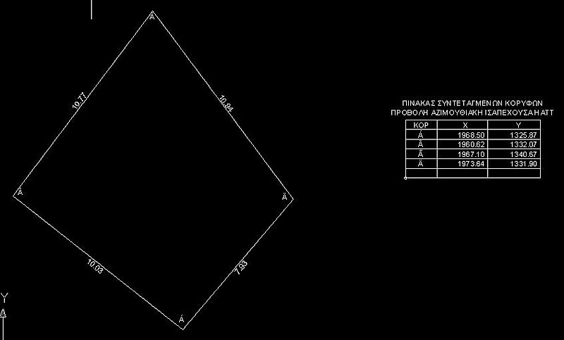

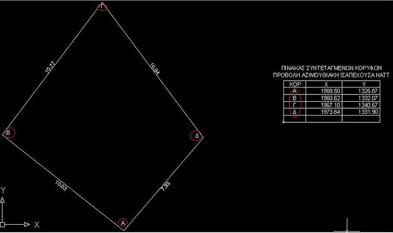

tagkelas Posted August 21, 2009 Author Posted August 21, 2009 Thanks for the answer Lee Mac. I saw that and I did it,but... If I modify it or erase it, it won't recognize the greek fonts. When you select a polyline it automatically adds a letter in every vertex in order. A,B,C ect (but in greek Α,Β,Γ..) See these samples with the previous routine (with some changings) The result is in 1.jpg but I need the second one (2.jpg) KORKTH.LSP Quote
Lee Mac Posted August 21, 2009 Posted August 21, 2009 You will probably need to use a font that supports greek :wink: Quote
tagkelas Posted August 22, 2009 Author Posted August 22, 2009 (command "style" "standard" "arial.shx" "" "" "" "" "") Is this correct? Quote
Lee Mac Posted August 22, 2009 Posted August 22, 2009 Perhaps something like: (commmand "_.-style" "standard" "arial.ttf" "" "" "" "" "") Quote
