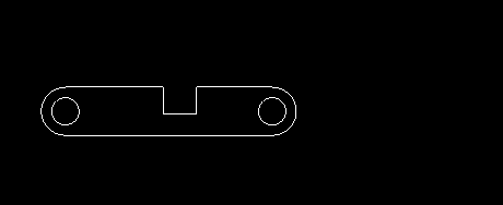

Ok well I am trying to grasp the stretch command and every time i try to select strech and then drag a box over one side of the box and type @20,0 the box move far to the right with no stretch . I did not encircle the entire box and when I try this command with lines forming a box then 3 lines move , leaving one behind . The UCS is set to World and i`m just scratching my head trying to figure out what i`m missing . Found an old thread on here but the author is listed as banned so no help there .
Can anyone tell me what i`m doing wrong ?????
Thank You
Autocad selects objects differently left to right and right to left. Depending on the object you'll just have to try it both ways.
KC
Wow thanks Kencaz , I can`t believe I was that close .
Your so right , I tried enclosing from the right onto an array of boxes and it selected fewer (omiting center row) than doing it to the left.
Really appreciate your reply . Thanks
