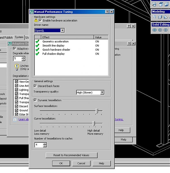

dvjstyles Posted November 4, 2008 Posted November 4, 2008 To make the Hidden visual style work correct – so you cant see lines flicker through at the rear – you need to turn on Tools / Options / System / Performance settings / manual tune & check the Enable hardware acceleration (at Open GL setting) . See the image below for the settings I had that resolved this. Quote
jerboi Posted November 5, 2008 Posted November 5, 2008 Even switching to open GL doesn't fix this bug, we use quadro 2500, 3000 and 1700:( Quote
