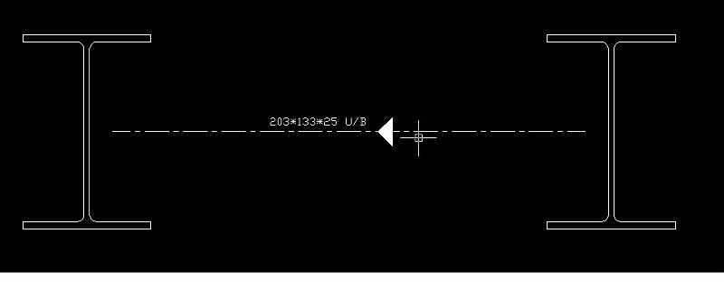

I am using AutoCad LT 09. I am looking for a way (lisp routine) to draw a line from point to point that has a "set back" at each end of the line. The line would look and act similar to a leader on a dimension but the set back would be at both ends. See the attached image as an example.
The end of the line would still be at the nodes to which it was drawn but the line would appear to be a bit short at each end. In the example the line object ends (handles) would be at the center of the I-shape objects.

First of all, you state you are using LT; LT does not have the capability to utilise LSP functions without the aid of some form of add-on, such as LT Extender.
One way to achieve the results you desire, would be to create a block which contains no objects; then create a new Dimension Style.
Within the newly created Dimension Style it would be possible to set the "arrowhead" to be the block you created earlier. This would then give the impression of there being a gap at the ends of the 'line'. Then create dimensions, instead of lines between the column positions
NBC, thank you for your idea. My LT does have an extender and we use all sorts of lisp routines.
I will give your dimension style a shot.
