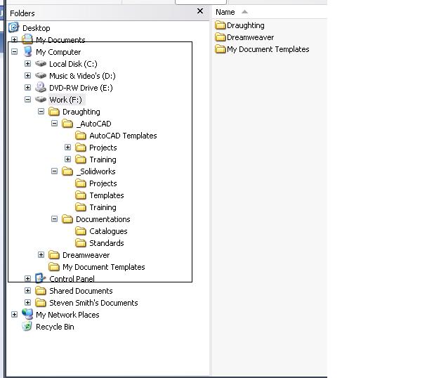

I'm getting a new super computer next week and I want to have a good, stong and efficient directory set up correctly from the beginning. the current structure is gobble de gook and all over the place.
I will be making a partition on the hard drive.
I will be running Autocad and Solidworks.
This is currently what I have, but I'm looking for ways to improve it.
do you have projects that require both autocad and solidworks?
here we break it by project first then what it is second so the whole project is together
Ahh, so rather than making an autocad folder and solidworks folder. I should set the main folder structure out by using say, the contractors name or project. That way I wouldn't be confusing to look up projects. I would just need to look for the company/name that I done the work for.
