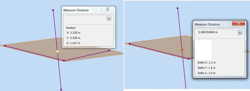

Autodesk Inventor has tools for this.
Not limited to plane - could be pierce point of any vector through any organic surface.
