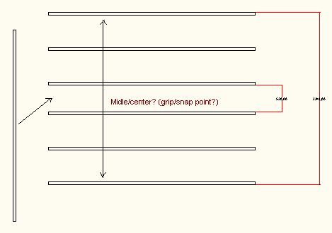

I need to center-align a rectangle to a group/block object (also it's midle), how do I do that?
Can I create/insert a grip or snap point in the midle of the group/block object?

Probably just draw a line from the points you care to put the rect. at the midpoint of, put it there, delete the line.

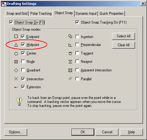

PERFECT......just what I was looking for, THANK YOU Glen Smith :D:D:D
(To get the middle of the first object, I used the command OSNAP and activated Midpoint, it was not activated by default.)
