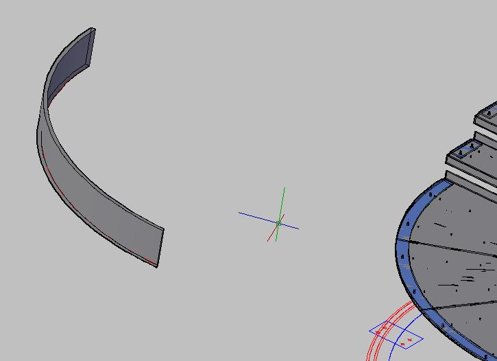

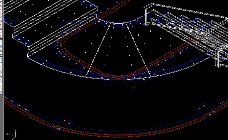

stevsmith Posted August 28, 2009 Posted August 28, 2009 Hi there, I am trying to detail the stringers for a staircase I am developing in 3D. The trouble is, I have hit a snag when it coms to devloping th curved riser section. See attached photograph. The main issue is the break off point as it is situated on the curve and not on a straight section. I have attached a cad detail of what I am looking to achieve. Any help would be gratly appreciated. HELIX STRINGER.dwg Quote
shift1313 Posted August 28, 2009 Posted August 28, 2009 Stev, im not sure i follow what you are trying to do. How will you actuall make the stringer? is this going to be metal or wood?(looks like metal from your drawing). Are you only looking to draw a curved stringer for the landing portion? Quote
stevsmith Posted August 28, 2009 Author Posted August 28, 2009 I managed to zip it. This is the stair to get a twin stringer. All steel construction. The 1st flight of stairs was easy, but i need to figure out how to sweep the rest of the stringers to suit the tread positions referencing off the plan view. The stringers are to be mitre cuts. no radii between joints. 425.zip Quote
shift1313 Posted August 28, 2009 Posted August 28, 2009 so is sweep not working for you? It seems as though you already have the correct path with the red lines in the plan view. I copied your red outter path from the plan view and moved it off into space. i then drew a rectangle. SWEEP, selected the rectangle, hit A for alignment and select No for aligning to path. then select the red line as my path. is the image what you are looking to do? Quote

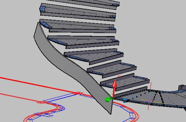

stevsmith Posted August 28, 2009 Author Posted August 28, 2009 What you have done is correct Matt. I have used the sweep on the Half Landing section like you have done, the problem lies with the 2nd flight on the staircase. As it comes down the 2 steps onto the half landing. the stringer has to curve around the line of the landing (the sweep you have just done) and intersect it so that it looks continuous. Im at home just now and I dont have AutoCAD on my laptop. Im getting my new computer next week. So Im trying to explain it as best as I can mate. Thanks for looking at it. Quote

shift1313 Posted August 28, 2009 Posted August 28, 2009 okay, when i first read it i thought you were having trouble with the landing. So you need something like this? Quote

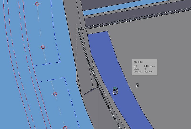

stevsmith Posted August 31, 2009 Author Posted August 31, 2009 Hey Matt, I appreciate you taking the time to help me out. I have attached a drawing showing what happens when I sweep both the half landing and the 2 steps. as you can see there is a collision that I need to turn into a mitre but as you can see, I cannot union the 2 stringers together. As the images show the mitre is on the curve making the geometry complex. Believe it or not but this stair has actually been made. all the developments were done in 2d which I can do no problem. This 3d is project for me to try and introduce it into or work. Quote

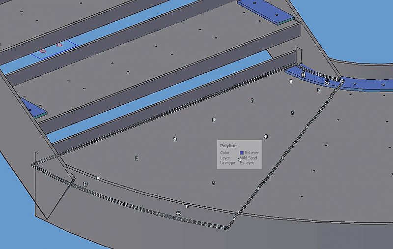

SEANT Posted August 31, 2009 Posted August 31, 2009 I re-read the thread again, and see where I was somewhat missing the primary gist. It is an interesting modeling problem, though, so I tried to create that one piece at the inside corner of the curved landing/riser section. It is quite a challenge. Stringer.dwg Quote
stevsmith Posted August 31, 2009 Author Posted August 31, 2009 How did you manage to get that? I'm fairly new to the whole 3d drawing in Autocad. Sometimes its trying to perceve how to draw things in a different perspective that throws me off. Im trying to figure out the steps you took but im getiing lost. could you explain how you achieved it in a bit more detail please. Thanks for all this help Seant and Matt. It's very much appreciated. Quote
SEANT Posted August 31, 2009 Posted August 31, 2009 I started out by making a quarter round panel with the appropriate thickness. That’s the easy part but, as you may have noticed, I used the outside radius for the inside. I really should pay more attention to the details. The tough part was generating the correct helixes to use as guides. The attached Excel spreadsheet has the calculations that I used. Once the 4 pertinent helixes are created they can be used as guides for the two lofted surface. Those surfaces can be used with the SLICE command. I had to first make a horizontal slice to restrict the Surf-Slice to just a portion of the quarter round. The pieces were subsequently unioned back together. HelixCalc.zip Quote
