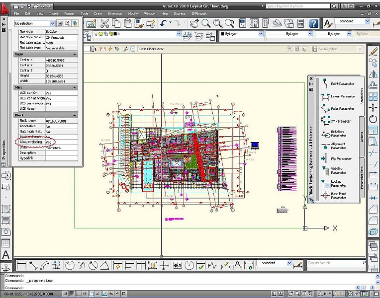

Cad64 Posted August 30, 2009 Posted August 30, 2009 Do you have anyone in your office that you can talk to about this drawing, because without seeing it firsthand, it's very difficult to speculate on what's happening. You said the drawing is a block but you can't Explode it, correct? If so, it could be that the block was created in such a way that it cannot be exploded. What you need to do is use BEDIT to open the block in the block editor. Once you have it open in the block editor, do not select anything, just open the "Properties" palette. In the "Block" section set "Allow Exploding" to "Yes". Now close the block editor and be sure to save changes. Once you're back in Model Space you should be able to Explode the block. Once you have the block Exploded, use WBLOCK to save out different parts of the drawing to their own drawing files, which I assume you want to use as Xref's for other drawings? Quote

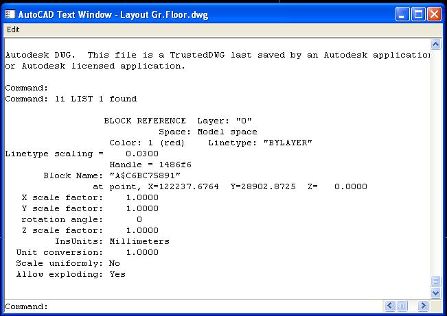

Shibuboss Posted August 31, 2009 Author Posted August 31, 2009 Good morning Mr. Cad 64 As you said i used the command "BEDIT".then property,i can see there "Allow Exploding - Yes " is active.here i am attaching the image1 for that, and check the property of that drawing 2nd attachment. Cad64 i am working one of our site office.i already check with my friends and collegues.after that i check with the consultancy.they are telling that they don't want to disclose their standard secret.so what do. Anyway i finished my job.without exploding the drawing. I used lots of lisps took from the cad sites to explode this drawing.it's not working.especially "EXPLODEM" lisp.i thought that it's a multiple block.i used the commands EXPLODE,XPLODE,BURST,FLATTEN,EXPLODE...etc..yet i can't get a right solution.after experience all these commands i posted this thread to forum. Is this drawing have any relation with "MINSERT".i read somewhere that minserted object can't be exploded.what's your opinion?my friend if you don't mind,i can send this drawings to your email.really i need a solution for this.coz i don't want to waste my working time play with such kind of drawings.please help. Regards_______ Quote

Cad64 Posted August 31, 2009 Posted August 31, 2009 i already check with my friends and collegues.after that i check with the consultancy.they are telling that they don't want to disclose their standard secret.so what do. If you've contacted the consultant and they told you that the drawing was locked in order to protect their intellectual property, then there is nothing we can or should do to help you unlock their drawing. If they wanted you to have access to it they wouldn't have locked it. But at least they provided you with a CAD file to use as a base. Some companies will only release pdf's. But as you said, the job is already done now, so no more worries, right? Quote
