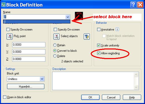

Sounds like the dxfs were made from blocks that didn't allow exploding. You can change that in the Block Definition dialog box; start the Block command.
Thanks I will try that. I believe I know what you are saying. My CAD is on another computer the kids are on so as soon as they are done I will try. I'm running AutoCaD2002. I really hope this works.

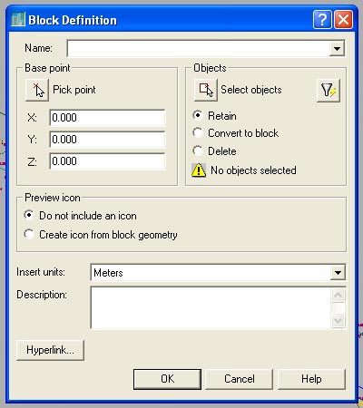

I don't think that there were Behaviour options way back in AutoCAD 2002.
But I don't see why DXFIN should not work starting with a new empty drawing. As each DXF file opens up in that drawing, you could do a quick LIST and see whether it had been made as a block, and if so, an EXPLODE would put matters to rights :D
