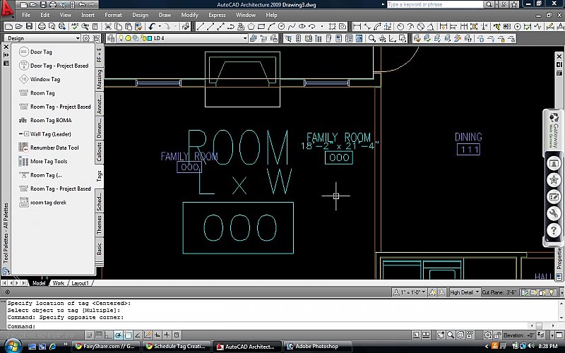

CADMASTER1128 Posted September 1, 2009 Posted September 1, 2009 OK, So here is what I did.... I first want to make sure I did this right as I have never used this feature before - If correct then I will explain my process. See attached Image: Quote
dcandmc Posted September 1, 2009 Author Posted September 1, 2009 looks great so far, except change the Room Tag a little, add another feature such as Length and width See, my post above for the correct property sets. And then try and reinsert it, If it still works for all the annotation scales, I would really like to know what you did. Quote

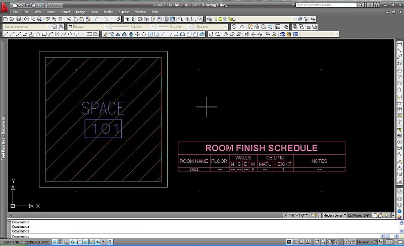

dcandmc Posted September 1, 2009 Author Posted September 1, 2009 I am new to the way this site uploads pictures so here is a try. Quote
dcandmc Posted September 1, 2009 Author Posted September 1, 2009 Now, I realize the tag was not anchored in the picture but it does work correctly, its the scale that is causing the issue. Quote

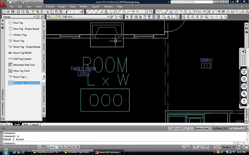

dcandmc Posted September 1, 2009 Author Posted September 1, 2009 Noahma I think your on to somthing, it is now at the right scale for this drawing but what if I should chose to change the scale to 1/8? Quote
CADMASTER1128 Posted September 1, 2009 Posted September 1, 2009 Noahma I think your on to somthing, it is now at the right scale for this drawing but what if I should chose to change the scale to 1/8?[ATTACH]14126[/ATTACH] If you have set to annotative then 1/8'' then the text will become 6'' text (when plotted) as long as it set to 1/4''=1'-0'' Quote
Noahma Posted September 1, 2009 Posted September 1, 2009 Noahma I think your on to somthing, it is now at the right scale for this drawing but what if I should chose to change the scale to 1/8?[ATTACH]14126[/ATTACH] Hmm. I will have to take some time to play around with that. About 98% of our plans are printed at 1/4 scale. I have yet to test it out in 1/8 Quote

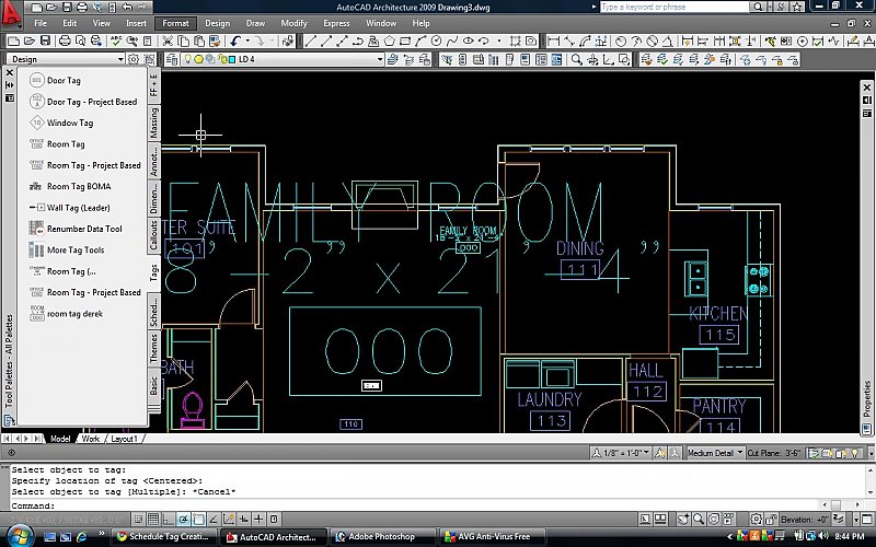

dcandmc Posted September 1, 2009 Author Posted September 1, 2009 Here is another Tag added using Annotation scale 1/8"=1'-0" You can see I have done something wrong because the text is way to large at this point. Now reason would say that if I could figure what scale factor it is increasing by I should be able to fix it. But I have yet to narrow that down. But will keep working on that Quote
