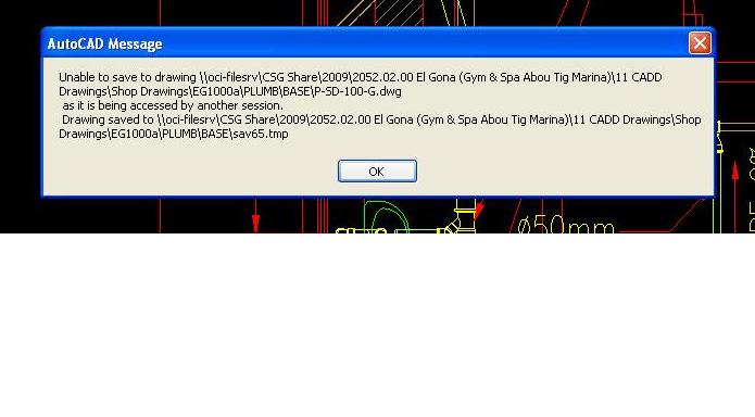

e.mounir Posted September 1, 2009 Posted September 1, 2009 Dear all I have a problem it is new for me this first time I see it, when I make save I found massaged said unable to save , please see the attached it will explain Quote
ReMark Posted September 1, 2009 Posted September 1, 2009 The key to your problem is in the line that says "...as it is being accessed by another session." Sounds like someone else was working on the same drawing at the same time you were. Are you on a network with other CAD operators? Quote
e.mounir Posted September 1, 2009 Author Posted September 1, 2009 Yes we are working on the server but I don't know why this problem happen Quote

ReMark Posted September 1, 2009 Posted September 1, 2009 When working on the drawing type the following at the command line to display ownership information for opened drawing files. WHOHAS "You can use WHOHAS to track which users have certain drawing files open." Quote

e.mounir Posted September 1, 2009 Author Posted September 1, 2009 All machine is shut down now and I can't save the drawing for this project only Quote
Cad64 Posted September 1, 2009 Posted September 1, 2009 Try SaveAs and save it under a different name. Quote
gsksun4 Posted September 1, 2009 Posted September 1, 2009 "Save as" the same problem Close the file and right click on the file name and click on properties. Make sure "READ ONLY" is not checked. Glenn USA Quote
