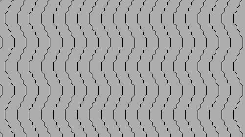

shamrocks Posted August 28, 2013 Posted August 28, 2013 when i add my custom pattern (wood.pat) to in the directory where the acad.pat file is located, and try to use the custom pattern in autocad 2010, I get an "Error in Pattern File"... here is the file contents: *WOOD4, 90, 0,0, 0,4, 3,-13 90, 1,4, 0,4, 1,-15 90, 2,6, 0,4, 1,-15 90, 3,8, 0,4, 3,-13 90, 2,12, 0,4, 1,-15 90, 1,14, 0,4, 1,-15 45, 0,3, -2.82842712,2.82842712, 1.41421356,-21.21320344 45, 1,5, -2.82842712,2.82842712, 1.41421356,-21.21320344 45, 2,7, -2.82842712,2.82842712, 1.41421356,-21.21320344 135, 3,11, 2.82842712,2.82842712, 1.41421356,-21.21320344 135, 2,13, 2.82842712,2.82842712, 1.41421356,-21.21320344 135, 1,15, 2.82842712,2.82842712, 1.41421356,-21.21320344 Quote
eldon Posted August 28, 2013 Posted August 28, 2013 (edited) There are two things which are necessary in stand-alone pattern files: 1) The file name must be the same as the characters in the first line of the file, between the * and the first comma. Your file should therefore be called Wood4 (upper case and lower case do not matter). 2) There must be a blank line at the end of the definition lines, before saving. Obviously I cannot see the blank line at the end of your file. Try both of those and you should see the pattern Edited August 28, 2013 by eldon adding picture Quote
shamrocks Posted August 28, 2013 Posted August 28, 2013 Thanks Eldon, Worked perfectly (but pattern is kinda 'blah').. lol. Quote
