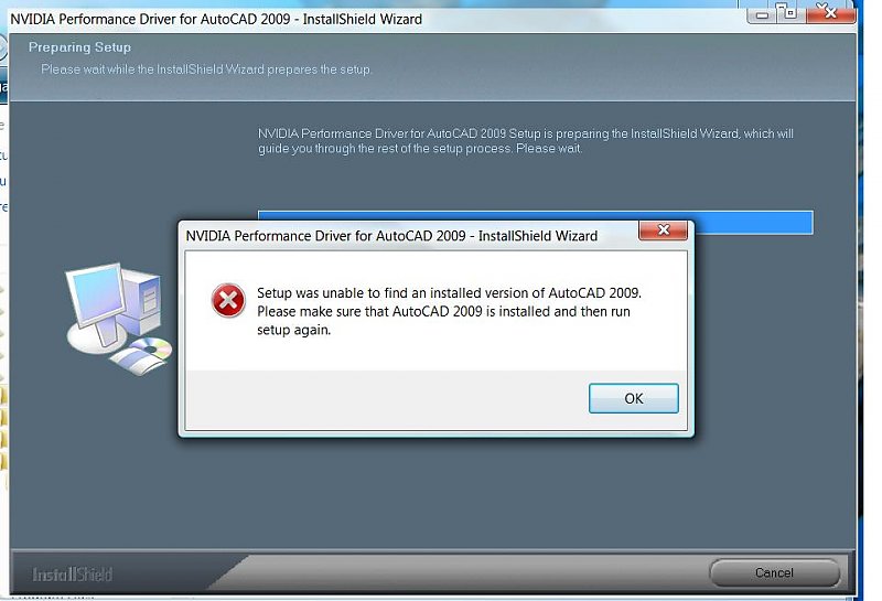

ok, so I get excited at the possibilities with this, so I download it. go to install and it says it can't find an installed version of 2009. :o Suppose it's cuz it's MEP ?? I'm going to reboot and re-try :( I appreciate the link!
ok so no go, if *anyone* running MEP figures out how to install this please PM me? Meanwhile I'm going after Nvidia....

The Nvidia documentation says that the driver should "auto sense" AutoCAD and start working without problem.

just found a bunch of updates for both Nvidia AND Vasta. re-booting once again......:x
The latest driver for Quadro FX seems to be 169.96 and this has the AutoCAD driver integrated. Autodesk haven't given it the official nod yet but since they were involved with the development, I guess it must be fine.
I'm at a loss. Need to contact Nvidia (somehow)
I'm running the Nvidia 8500 GT
(w/ dual quad core Q6600 4 gig RAM)
system is 2 moths old....

I've got the same exact problem, is it because I have a LT 2009?
After driver upgrades still can´t install performance driver.
Specs: Windows Vista Enterprise SP1 32 bits
Intel Xeon X3350
2 Gb DDR 3 1333
Intel Desktop Board DX38BT
Pny Quadro FX 570
Has anyone been able to install performance driver on LT 2009?

I too am having the same prob with Civil 3D.
Would be great to know if someone's found a work-around.

Well, I've also gotten the boot with this on Civil 3D.
Has anyone found a solution for LT or verticals?
