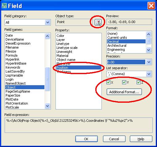

Create a Point; then create 2 fields using the point as the Object Type and Position as the Property. Specify Y position for Northing and X position as the Easting. Under Additional Format you can specify prefixes, e.g. N: E:. then make it a block using the point as the insert point.
