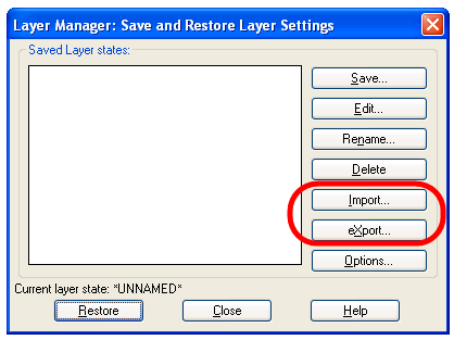

Hi NBC,
at the moment I have only access to acad2005.
Here's a screenshot:1.png
Thaught this would look similar in acad2009, maybee I'm wrong.
regards
Wolfgang

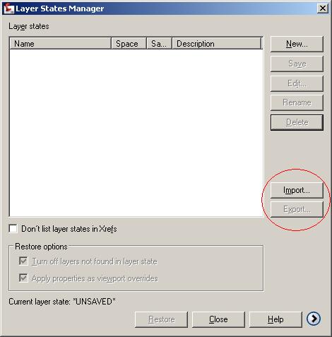

Hmmmm, that is the old LMAN dialogue box. There is nothing like this in 2009 version for layer filters :(
same options in 09, but these are layer states, not filters.
