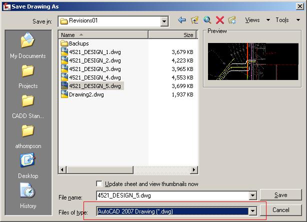

my client has files in autocad 2009 lt...how does he save them back to 2005?
Click on the down arrow and save as any version required; i.e.: 2005.
I usually save as version 2000, and never a problem.
There is no 2005 format.
Available dwg Formats
2010
2007
2004
2000
R14
Sorry, I always save to 2000 at the request of my clients.
I have the default save as set to version 2000 just to make it easy on myself.

I think the CAD drawing viewer program CADwizz has the ability to save in any one of the previous file formats.
DwgTrueView, free from the Autodesk website can save/convert any Autocad version to any other.
So if you only have 2000 or 2002 you can use Dwgtrueview to access any other format up to 2010 and convert it to what you need.
