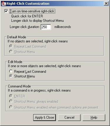

chelsea1307 Posted September 9, 2009 Posted September 9, 2009 So i was browsing through the tips and tricks sticky and was trying to use some of the suggestions and have come to find out after starting a command i cannot right click to bring up options (like osnaps and other stuff) instead it cancels me out of the command. Any ideas why or how to fix it? edit: i attached a picture of what my right click customization looks like incase it helps Quote
CADMASTER1128 Posted September 9, 2009 Posted September 9, 2009 This still isn't working correctly for you? I have the same settings as you (I have not adjusted anything) Have you tried to restart CAD or computer? Quote
chelsea1307 Posted September 10, 2009 Author Posted September 10, 2009 Yea, restart my comp daily and close and open cad daily, its been happening for a while just now thought to see if there was a solution or easy fix Quote

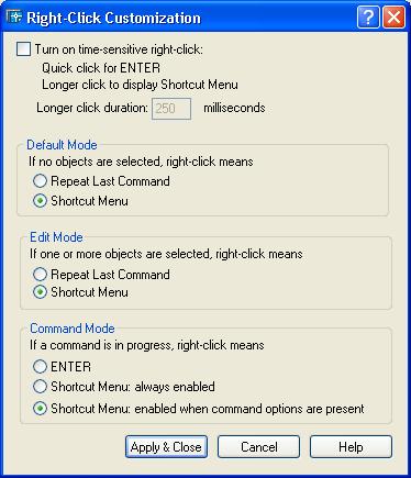

alanjt Posted September 10, 2009 Posted September 10, 2009 Get it set how you want it, then type (getvar "shortcutmenu") and place this in your startup: (setvar "shortcutmenu" #). #: number returned by getvar. Quote
chelsea1307 Posted September 10, 2009 Author Posted September 10, 2009 I dont know how to get it set how i want thats the problem Quote

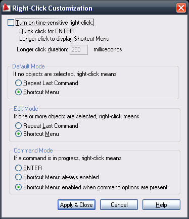

alanjt Posted September 10, 2009 Posted September 10, 2009 Command: (getvar "shortcutmenu")18 Command: These are my settings. If I want the right-click menu to display, I just hold the right button down and it will display. Quote
chelsea1307 Posted September 10, 2009 Author Posted September 10, 2009 I matched my settings to yours and still no luck. I select on object start a command (move for instance) pick my basepoint right click to get snap options and it cancels my command and with the setting matching yours deletes the object that had been selected Quote
alanjt Posted September 10, 2009 Posted September 10, 2009 I matched my settings to yours and still no luck. I select on object start a command (move for instance) pick my basepoint right click to get snap options and it cancels my command and with the setting matching yours deletes the object that had been selected Are you holding down, either the Control or Shift key when you right click for the snaps? Quote

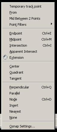

alanjt Posted September 10, 2009 Posted September 10, 2009 nope, should i? That's how you access the Osnap menu. You are referring to this, right? Quote
chelsea1307 Posted September 10, 2009 Author Posted September 10, 2009 hmmm, ok, it works doing it that way... i seem to remember a different menu with osnaps as a side option Quote
alanjt Posted September 10, 2009 Posted September 10, 2009 hmmm, ok, it works doing it that way... i seem to remember a different menu with osnaps as a side option Before the ability to zoom in/out with the wheel, you could click the middle button and the Osnap menu would pop up. Quote
