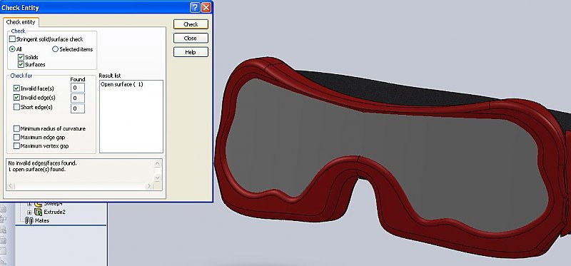

under the tools menu you have something called CHECK and Assembly Expert. These will diagnose files that are fine. If you have an error in your design tree and you right click on the component you will see "What's Wrong". this will diagnose errors. Here is a screen shot of a component tha has no errors, when Check was run, it shows an open surface. Things like this may cause issues when exporting or opening files in other programs. This may not be the issue but i find more times than not, issues in one program usually result from geometry. When you bring files into solid works it will auto-check them, find gaps or small features and so on.
I fixed one little issue and it opens up for him now! Thanks again Matt!
