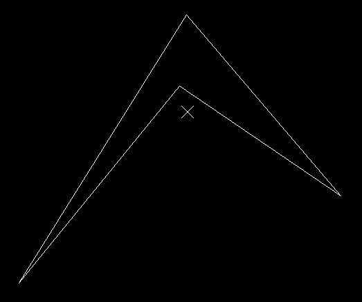

But using the pline centroid doesn't ensure you to offset inside the polyline.
The polyline centroid may be outiside the polyline:
Using the vla-Offset function with a closed polyline can be a way to ensure an "insde offset".
The help file for the vla-Offset function say:
"The distance to offset the object. The offset can be a positive or negative number, but it cannot equal zero. If the offset is negative, this is interpreted as being an offset to make a "smaller" curve".
With a closed polyline, this is true if the polyline is counterclockwise, and it's inverse if the pline is clockwise.
A way to know if a pline is clockwise ir counterclockwise is to calculate its algebraic area: a negative area means the pline is clockwise.
The InsideOffset routine requieres two arguments: a polyline (ename or vla-object) and the offset distance (a positive real number).
You can test it using: (InsideOffset (car (enstel)))
That LISP doesn't work either. You are having it print pline-centroid but that was never defined in your lisp.
Man, it sure is hard to get the center of a polyline.
