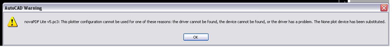

Lox Posted September 15, 2009 Posted September 15, 2009 Hi all, I downloaded PrimoPDF, as soon as I right-click on the "Layout 1" tab and choose Plot i get this error message? I cant work it out, i can still then go onto the Plot dialoge box if i press ok but its really anoying, has anyone else had this problem? Also when i do plot a drawing and saving the PDF it also creates a annoying little text document beside the PDF? can i stop this? Any ideas? Quote

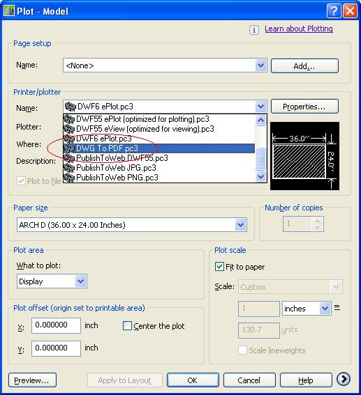

CADMASTER1128 Posted September 15, 2009 Posted September 15, 2009 You could also use the DWG to PDF plotter (which comes with AutoCAD) See the attached image.... Quote

stevsmith Posted September 15, 2009 Posted September 15, 2009 You could also use the DWG to PDF plotter (which comes with AutoCAD) See the attached image.... Is this available in 2008? I thought plot to pdf appeared in 09.. I could be wrong though. Quote
skipsophrenic Posted September 15, 2009 Posted September 15, 2009 Is this available in 2008? I thought plot to pdf appeared in 09.. I could be wrong though. Even though the option is availiable in 08, i still preffer using CutePDF Quote

CADMASTER1128 Posted September 15, 2009 Posted September 15, 2009 Is this available in 2008? I thought plot to pdf appeared in 09.. I could be wrong though. Yes, the screen shot was taken from Architecture 2008. Quote
Lox Posted September 16, 2009 Author Posted September 16, 2009 Great call on CutePDF, cheers guys. Still getting the anoying error message tho, is there a way to delete a page setup from the Page Set up Manager? coz i think if i delete that novaPDF lite thing it might go away. Quote

chelsea1307 Posted September 23, 2009 Posted September 23, 2009 Great call on CutePDF, cheers guys. Still getting the anoying error message tho, is there a way to delete a page setup from the Page Set up Manager? coz i think if i delete that novaPDF lite thing it might go away. Have you uninstalled novaPDF yet? If you go to page setup manager you can select the setup that has novaPDF and either delete it or edit it to use cutePDF Quote
