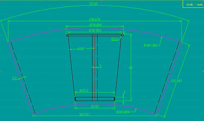

mozart Posted September 17, 2009 Author Posted September 17, 2009 i tried that but when measured the angle it came out different from i put in. is there any way i could set the angle after i made the arc? im trying to make a fan-like shape. thanks again. Quote

mozart Posted September 17, 2009 Author Posted September 17, 2009 home - utilities - measure - angle this is the drawing i been meaning to do (for weeks) Quote
Strix Posted September 17, 2009 Posted September 17, 2009 sorry, I'm not grasping what you're stuck with did you not draw that? are you just trying to replicate it? Quote
mozart Posted September 17, 2009 Author Posted September 17, 2009 im trying to replicate it. basically the fan-shape. but still dont know how to create with the correct measurements and all. Quote
Strix Posted September 17, 2009 Posted September 17, 2009 do you have the option of RADIUS and CHORD in your range of ARC commands? you're given both of those for each arc if you want to do it the awkward way, draw a vertical line of the correct radius, then COPY and ROTATE it, then fill in the ARCs If this is a school assignment, your tutor will be able to interrogate your method through your drawing :wink: Quote
