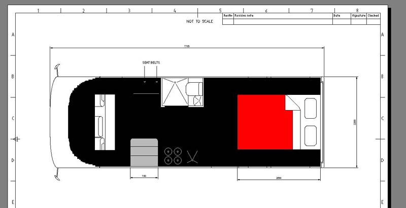

Hi guys,

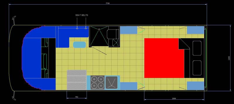

Any ideas why when i go to plot this drawing its comes out like this???? I'm guessing it has something to do with the way i have done the hatching and the colors but i can't figure it out, i have created a layer for each hatch and assigned a colour to it, then when i use the hatch i have "By Lay" set as the colour at the top?
Help please!
Lox
the ctb file you are using may have those color set up as print black. to overcome tis without changing the ctb file use true colours for hatching. good thing is your hatch color is bylayers so, you can chnage the color assigned to each layer to similar true color in layer manager
