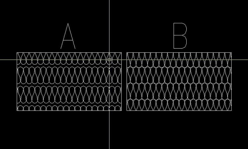

Thankyou Hugh,
That was just the advice I needed, I was not amendeing the correct PAT file nor was I looking in the right directory.
Having now reviewed the pattern, can you help with the pattern itself? I would like to amend the appearance slightly (See attached image) from A to B.
Any help you can give would be much apreciated.
