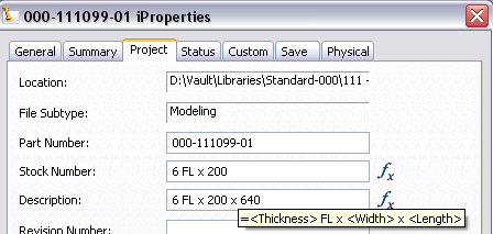

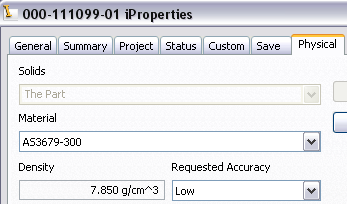

I have set up our system in such a way that the BOM is populated entirely by the iProperties of the parts and assemblies.

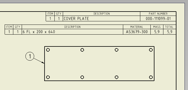

I have created two different parts list styles, one for Materials, one for Parts. You can create any type of table you like, containing any number of iProperties you want to display.
This way I can model a plate, assign a material (or material standard), assign model parameters to the ‘description’ field in iProperties (6FL x Width x Length), give it a Title (Cover Plate), give it a part number, and have all of these properties populate my BOM. I can use the plate to detail for manufacturing and have the correct material description, and I can use this plate as part of an assembly and have the correct part number. Any changes I make to the model (overall dimensions for example), will be reflected in my BOM. If I make a change to my part, this change will be pushed through to every single assembly/drawing I have used this part in.
Now, say that I need another plate that is exactly the same except that it’s made from aluminium. What you would do in your system, is to simply override the material description and the part number in the BOM itself, because visually there’s no difference. Job done. However, as you’ve noticed there’s no longer a link between the line item and the part/assembly itself.
In the system I use, I would save the plate as a new part file (or create it as a derived part, so it maintains the link to the base component), assign the correct material, change the part number, and create a new assembly (save as) replacing the steel plate with this aluminium plate. Because I have physically separate files, I can give them separate descriptions, and maintain their link in the BOM without overriding any values.

First, lets make sure we don't get confused with naming conventions; Every part, assembly or IDW has 'iProperties'. These iProperties contains fields with values that can be set to certain values (using Expressions and parameters), and be read out elsewhere (in a BOM for example).
An iPart (and iAssembly) is a component that can have various configurations based on values in an embedded table. You end up with a 'Parent' part/assembly (the iPart or iAssembly), and every different configuration is a 'Child'.
In the example of the plate, I could make an iPart by making a table with Length, Width, Thickness, Part Number, and probably Material (haven't tried that yet), and simply entering all the values I would like to have for the different configuration.
Unfortunately, these values cannot be assigned to the 'Description' field using an Expression. In order to get the material size in the Description field, you will have to add the Description field to your iPart table, and set the correct value manually as text (so 2 FL x 30 x 100, not = FL x x ).
I use the Expressions in the Description field, so all I need is a folder with templates containing my most used profiles. (Flats, Plates, EA's, UA's, pipes, etc). When creating a new part I can start with the appropriate template and have all my parameters mapped and ready to go, all I need to do is change the length of my extrusion anywhere from 1 to 6000mm and that's it. This works much better than turning my profiles into iParts, because you can't make individual edits to them because they're essentially derived solids. iParts work well for library components.
