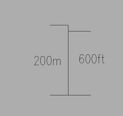

eldon Posted September 30, 2009 Posted September 30, 2009 I do the layout of an Agricultural Show, and all the trade stands are in multiples of 10 feet. Apparently, the canvas tents only come in Imperial dimensions. One year, the organisers tried to metricate the stands making a 6m stand instead of 20 foot as previously, and every one noticed. They were complaining about the missing 4 inches. So now I draw up the stands in Imperial measurement, but take off the setting out coordinates in metric. To help me swiftly change from one system to the other, I have set up a scaling line, based on 0,0, so I can scale everything by reference. Works a treat. Quote

KiLLiNG-TiME Posted September 30, 2009 Posted September 30, 2009 Inches to Millimeters 1 25.4 2 50.8 3 76.2 4 101.6 5 127.0 6 152.4 7 177.8 8 203.2 9 228.6 10 254.0 11 279.4 12 304.8 13 330.2 14 355.6 15 381.0 16 406.4 17 431.8 18 457.2 19 482.6 20 508.0 21 533.4 22 558.8 23 584.2 24 609.6 25 635.0 26 660.4 27 685.8 28 711.2 29 736.6 30 762.0 31 787.4 32 812.8 33 838.2 34 863.6 35 889.0 36 914.4 37 939.8 38 965.2 39 990.6 40 1016.0 41 1041.4 42 1066.8 43 1092.2 44 1117.6 45 1143.0 46 1168.4 47 1193.8 48 1219.2 49 1244.6 50 1270.0 All the above are correct you should never change units mid job etc, but if you have to, scale away chart above helps as does the cool image posted above by eldon (very smart). Quote
