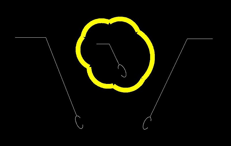

I made a leader with a custom block arrow head. when i draw the leader left to right, the block arrow head look good, but when i draw it right to left, it doesn't. I would like the arrow head to flip, or match the orientation of the leader. please see the attached image, and you will notice the difference; basically, i would like to be able to draw a leader from right to left and have it look like the clouded leader in the attached image. I was wondering if there is a setting when making the block, or in the leader settings?

Why not construct a right and left versions of the block? Wouldn't that work?
dynamic blocks can be used for leaders, but you will need to explode the leader once in drawing to be able to use the dynamic features.
My last resort is a left and a right leader, but hoping first that there is a solution for my problem.
