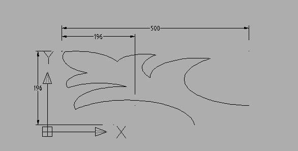

The graphic in the attached drawing is 196x196 square. I would like to stretch the graphic to say 500 long but remain 196 tall. Can I have some help please?
Thanks in advance.
to stretch.dwg
First you need to make it into a block. Then when inserting this block back into the drawing, you have the opportunity of making the X scaling 2.55, and the Y scaling 1. Then explode it if you need the lines separately :D
