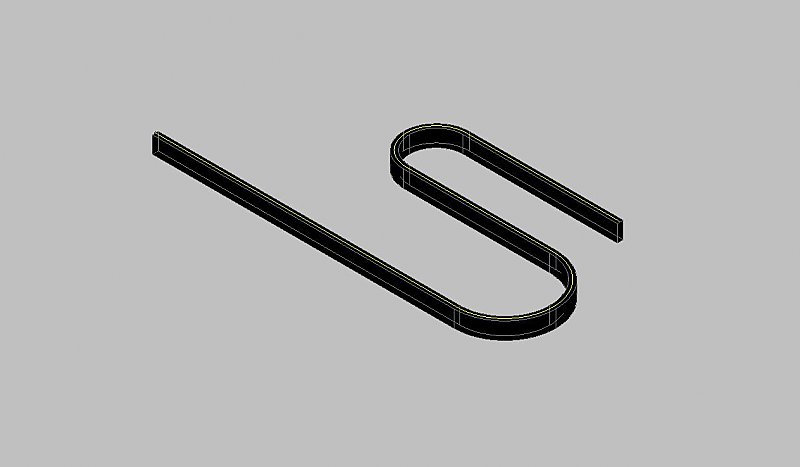

ReMark Posted October 5, 2009 Posted October 5, 2009 No thickness is not important on ether circles or polylines, I do need to see a shadow of the block swept around if it can be done. Like this? Quote

ReMark Posted October 5, 2009 Posted October 5, 2009 That exactly what if after, how? I rotated/oriented the block the way you wanted it to "hang" off the conveyor and then used then SWEEP command. That's all. You could also do it in a similar fashion by moving the block to the polyline (after reorienting it) and using the EXTRUDE command. Quote

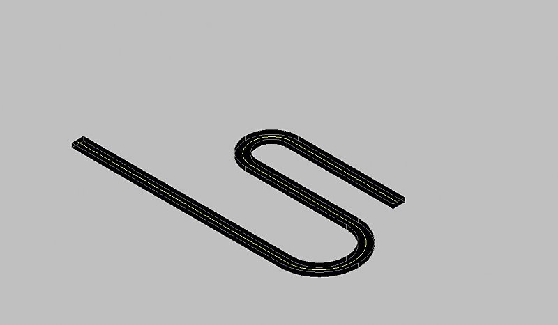

lonie Posted October 6, 2009 Author Posted October 6, 2009 This is what I wanted to do, but had to do it manually. Tried to sweep it around but it flipped the rectangle. I use it to check clashes. The issue is very similar to this link. http://www.cadtutor.net/forum/showthread.php?t=17410&highlight=fixed+path Sweep.dwg Quote
