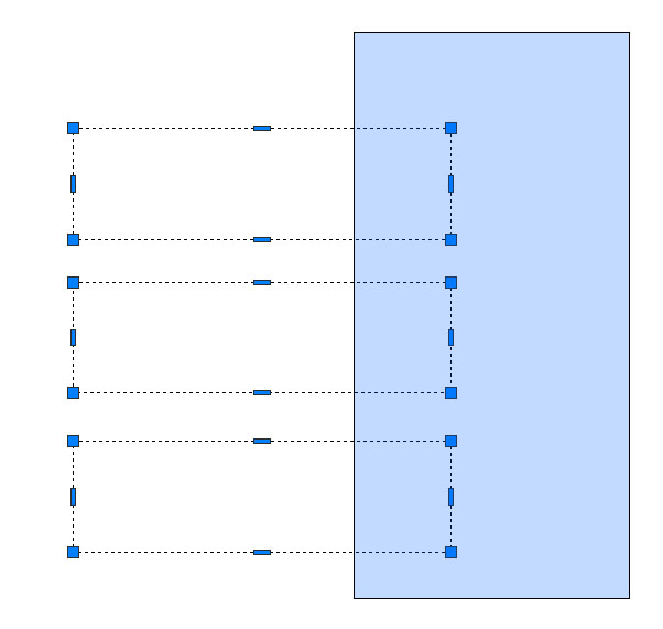

An ordinary crossing window with the mouse should do for you.CrossingWindow.jpg
Yes, that's what I meed to do. By default AutoCad do not select the vertexes of rectangles. How to make it work?
I have started the Stretch command before this selection works, but as this picture shows, all the selected ends are moving together.
What you appear to be doing is to just show all the grips without highlighting them, which has to be done one by one :cry:
Finaly it works :D Thank you eldon! Saved lot of mine time :)
