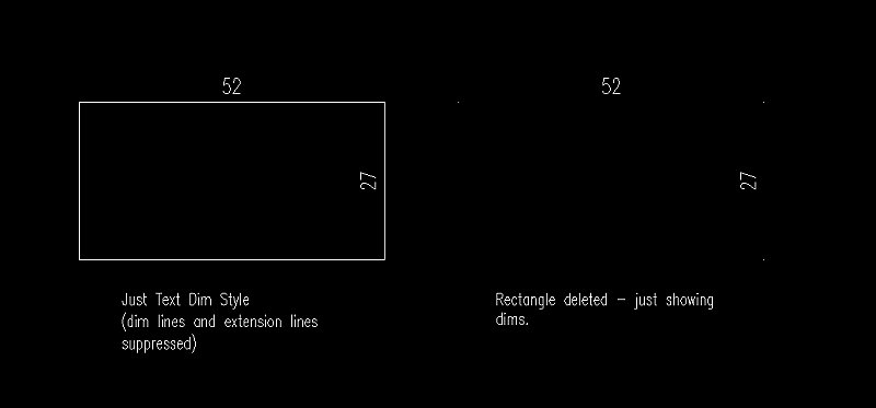

dbroada Posted October 6, 2009 Posted October 6, 2009 why not use dimensions? You can turn off all the lines and arrows if you only want text. Quote
Doove Posted October 6, 2009 Posted October 6, 2009 Don't think you're going to get much joy; possible you could request someone to write a lisp routine for it. However, if you have dynamic input on, then when you select an object you get it's associated parameters, e.g. a selected line shows it's length. If you want something more permanent you can add mtext above / next to the line then insert a field, liniing the field to the length property of the specific line object. If you then modify the line length you will need to regen the drawing to update the fields. Though you can also use updatefields. Perhaps a better solution would be to use dimensions but create a dim style without any lines or arrows, just text? Quote

fuccaro Posted October 7, 2009 Posted October 7, 2009 Well, you can create a FIELD to show the length of each line. But as previously mentioned, it is not as fast as dimensioning. Not to mention, for often use you can define a dimension stile to show only the dimension text. From that on, it is a few clicks to insert a number for a line OR use QDIM to dimension all the lines from a snap. Quote
