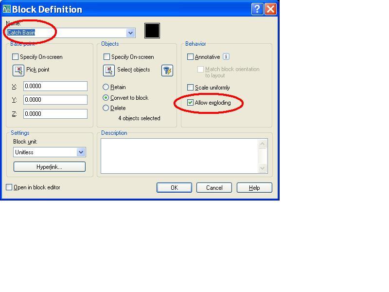

Start the block command, select the block, check "Allow exploding"
Oooooooooook. So I didn't have time to try that out yesterday, but I assumed that it would work. I'm having trouble editing the block definition after the blocks are already drawn. So I go into the Block Definition box and I choose the particular block that I'm working with and I go to the "Allow exploding" check box and I check it. After hitting ok I get the message "conv is already defined. 139 block references already exist in the drawing. Update the defintion and all of its block references?" I hit yes and it it deletes all of the 139 blocks. So can I change this property after the blocks have already been drawn?
you should be selecting an existing block THEN open the block editor. It sounds like you are selecting your block name while already in the editor so redefining your blocks without any geometry selected.
When I do that it still tells me to specify what block name I want to modify. Then the same thing happens
I just tested it as I explained previously, worked for me.
This may be an LT thing then. Try exploding one instance of the block first. Now when you have dialogue box up use the "select items" option to pick the exploded parts before continuing.
It still won't let me explode any of them. lpseifert: I tried it again but every time I keep getting the same message. When I tell it to update all of the objects it just deletes them.

Have you got a screen shot of the block editor (like LP did) and the block selected?
here you go. The objects I'm trying to explode are the orange conveyer lines. That's the message I get when trying to allow exploding for these objects
