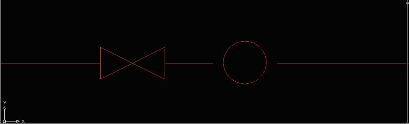

I have a lisp to insert blocks, 90% of them work fine, the block being inserted is the same size a few of them break the line they are being inserted on too much, the first one below inserts fine, the second one leaves a gap between the edge of the block (a circle) and the pipe (just a regular line in acad) Ive attached the blocks, i know it has to do with pt 1 and pt 2 but I dont know how to change them to the right points.

the image below shows GV (the first block on the line) with the line broken at the edge lines of GV, then it shows the circle priser and the lines the do not meet with the edge of the circle. i want them to meet with the edge like it does with GV
The "priser" block is smaller than the GV.
In the line that reads:
(setq dis (* scl 0.0703)
change it to:
(setq dis (* scl 0.0469)
since that is the value of priser's radius
sorry for the late reply was gone for a long weekend. That works perfect... Thanks
