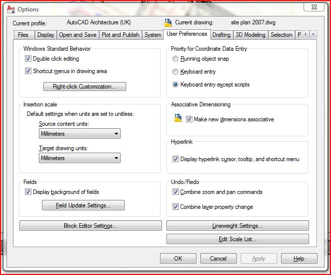

Does anyone know how to access Initial Setup in AutoCAD 2010 Student Version? Its meant to be in Options>User Preferences but I couldn't find it in the window. Could it be because its a student version??

To change the initial set-up of the software e.g. default template etc.
I've seen screenshots of the Options>User Preferences window with an 'Initial Set-up' tab at the bottom left corner, which is missing on my version of AutoCAD!
Maybe if it's because you are using Architecture and not just plain Autocad? Just a guess. :unsure:
There's not much to change in the Initial Setup dialog. The first page of the setup dialog lets you choose the drawing environment, (Architecture, Civil, Electrical, etc.). You're already using Architecture, so that page is irrelevant for you.
The second page lets you pick a Workspace, but you can do that from the "Workspaces" toolbar.
The third page lets you select your default template, but if you want to change your default startup template, just go to the "Files" tab and then scroll down to "Template Settings" and then select "Default Template File Name for QNEW". You can set your startup template there.
That's it for the Initial setup dialog. You're not missing much.

I am on the 2010 trial version and am having the same problem.
There is no functional difference between student version and commercial version. In fact, with the correct serial number the trial or student version can be registered as commercial.
Either go to Options>Profiles tab and select Vanilla profile
or
Go to Start >Programs>Autodesk>AutoCAD Architecture>Run as AutoCAD, rather than starting from desktop icon. (You can drag a vanilla AutoCAD icon to the desktop if desired.)
