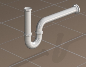

Remark is correct. I did this using surfaces in R12 in a few minutes. Not the quality of solids though. -David
Nice one David.
Doug: Using Pline, Fillet, Circle, and Extrude (with Path option) you can probably get acceptable results in about one minute (no fittings and not hollowed out). I just tested it out using 2004.
